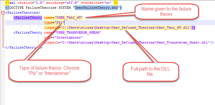

An XML file should now be created. This XML file provides a name for each failure theory and points to the corresponding DLL. A template of such an XML file can be found under:
$NX_BASE_DIRECTORY\NXCAE_EXTRAS\laminate\UserFT\xml\Template.xml
The XML should be modified as shown below:
Figure 7: XML file that defines the name of the failure theories and provides the path to their corresponding DLL.
In this example, the name of the XML is “UserFailureTheory.xml” and is located in the same directory as the DDLs files.
Figure 8: The XML file and the DDLs are placed in the directory User_Defined_Theories
