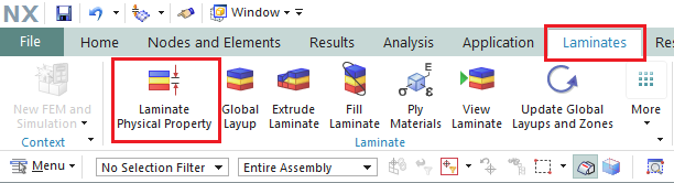

To define the laminate properties, In the Laminate tab click Laminate Physical Property to define the laminate layup.

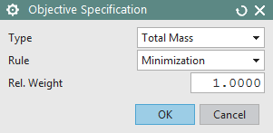

In the Laminate Optimizer Configuration dialog, under the Opt Design Space tab, and under the Objectives group, click
to define the objectives. In the Objective Specification dialog, set the Type to Total Mass and set the Rule to Minimization, and click OK.
Figure 9: define design objective

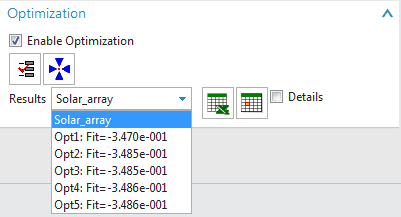

Finally, using the Results drop-down menu, you can choose one of the candidate optimum designs and the laminate definition is automatically updated to the layup of the selected optimum design (Figure 14).
Figure 14: Select one of the five optimum candidates
